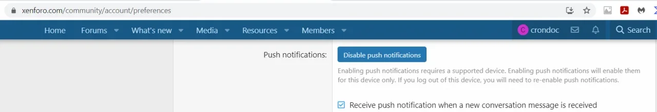

Interestingly, I got an email notification from this website when you replied to this thread, but no push notification, even though Im logged in on Chrome/Windows 10 and on Chrome/Android Moto G8 phone and I have push enabled.

Thanks for the suggestion. I had tried that as well as both devices. Reset permissions and clicked "enable push notifications" as well for both xenforo.com and for our own forum.

Right, finally sorted this. On my phone I had to allow notifications globally in android settings - even though some apps were able to over ride this. On Windows I reset Chrome and it worked.
