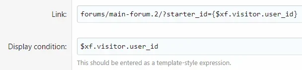

Trying to create a Link for the public navigation that is a predefined search link that takes the member browsing to search results with threads they started in a specified forum. The forum ID is 205. Pretty sure the user criteria is $xf.visitor.username but not sure about the forum criteria and how to structure the link to work in the public navigation Link field.
Actually, this is better as the above results in a broken link when the tab is focussed (if you're using a tab).
{{ link('forums', {'title': 'Main forum', 'node_id': 2}, {'starter_id': $xf.visitor.user_id}) }}

I was able to get the results to display only the threads I've posted in a specific node so it looks like that should work, it just won't include threads in the child node. Not ideal but fine for now.
