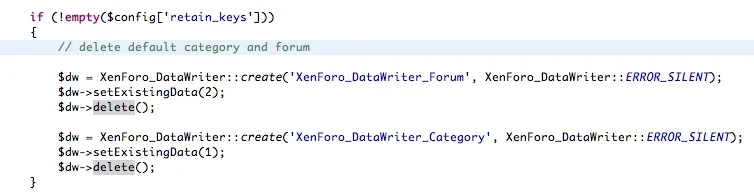

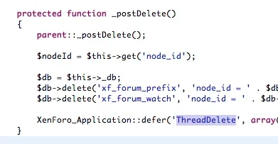

The only instance that I could fine that triggers the ThreadDelete is the one that Mikes mention, when a Forum is deleted and _postDelete() is invoked

The deferred task is there, and it is being triggered by Configure, but it was not added by the Blogs Import process.
Sadly, the Stack Trace is telling me that it is trying to run a ThreadDelete, but it does not tell me which add-on, file, or process added it.

Well, the edits to ThreadDelete are preventing anything new from being added ...
It would be nice to know what is adding them, though. I sent you the edited ThreadDelete.php file in a private conversation. That would give you an entry in the Error Log whenever something tries to add a defered task to delete threads.
Blogs does not delete Forums or Threads ... what else do you have installed?

#4 /home/admin/public_html/demo/library/XenForo/DataWriter.php(1767): XenForo_DataWriter_Forum->_postDelete()
#5 /home/admin/public_html/demo/library/XenForo/Model/Node.php(1148): XenForo_DataWriter->delete()
#6 /home/admin/public_html/demo/library/XenForo/DataWriter/Node.php(245): XenForo_Model_Node->deleteChildNodes(Array, false)
#7 /home/admin/public_html/demo/library/XenForo/DataWriter.php(1767): XenForo_DataWriter_Node->_postDelete()
#8 /home/admin/public_html/demo/library/XenForo/ControllerAdmin/Import.php(73): XenForo_DataWriter->delete()

Now we are on to something
That retain_keys flag is explicitly deleting a Forum and Category
... When you import the blogs, do NOT select the "retain keys" option.
If you do, that is when the "Delete Forum" kicks in.
I am not sure if I can fix that and still reuse the import logic in vBulletin (I just added a new Importer, and that seems to be in the main controller). I wonder if that will also be a problem with people trying to import "2 forums into 1" (but then again, when doing that retain keys is a bad idea anyway)
