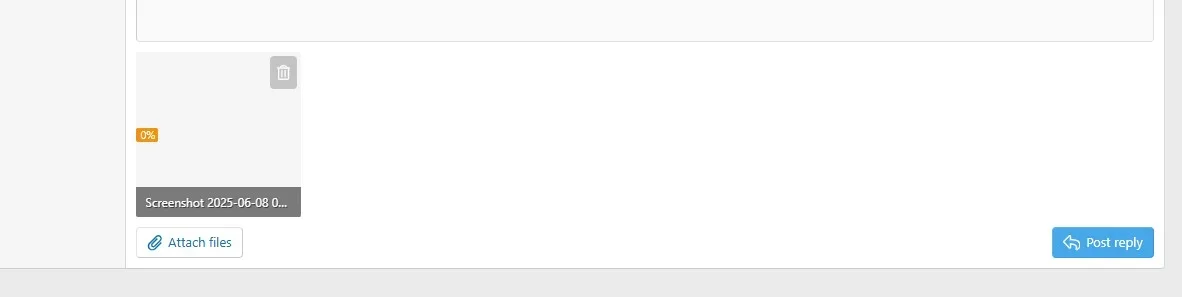

I've just upgraded to the latest forum software from v1 and most things are working but I can't upload files in posts.
When I try the image just shows 0% upload. I assume there are some permissions that are not right somewhere but the data directories are writable.
Further to this it looks like its a not an issue for all users.
Could there have been some permission changes somewhere?
[Updated]
It worked from someones phone then after trying from a PC the upload failed from a phone again. Weird behaviour and I'm not sure where to look,

You’re dealing with a new image type webp it’s supported on most current browsers. Go to ACP > settings > attachments and turn off Optimize images.
But your test image is webp try another type and see if it fixes the problem.
I've tried png and jpg neither worked. I'm thinking the console error is suggesting that it may be a webserver issue it seems to be suggesting its a some sort of policy error (I will check my webserver setup).
