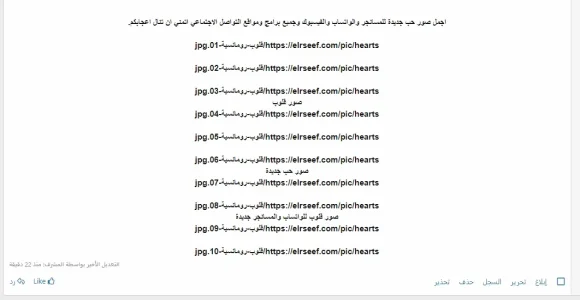

Currently, while I am browsing the topics, I have a problem with the image links on the topic, where the image links appear and the image does not appear directly.
I hope to find the solution. I have a lot of old articles with the same problem
Example

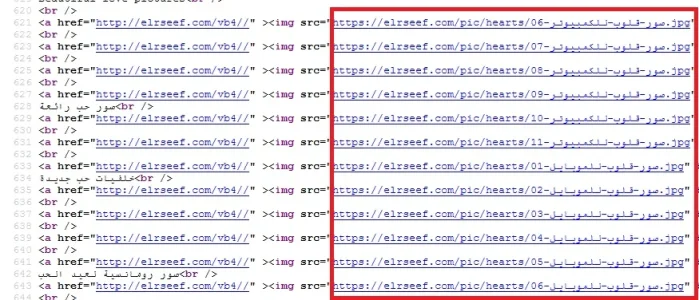

How do those URLs appear in the source database?
Are they like this?
https://elrseef.com/pic/hearts/الكلب-الأصفر.jpg
You can view the page source or the raw post content in VB to check that.
Are they like this?
Hi Brogan
Yes, it appears as I explained in the example in the source page of the Forum vb4
I'm pretty sure this is ultimately the same issue as this:
Based on what's shown, the URLs aren't technically valid as the non-ASCII characters should be URL encoded. However, the change for the linked issue should retroactively restore these links.
