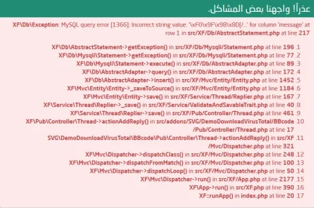

Chris D XenForo developer Staff member Feb 1, 2019 #2 It sounds like you have: PHP: $config['fullUnicode'] = true; In your config file, but you haven't yet converted your database to support emoji. The instructions for that are here: Emoji support | Manual | XenForo End-user documentation for XenForo xenforo.com Otherwise you will have to set the above config value to false (or remove that from the config). Upvote 0 Downvote
