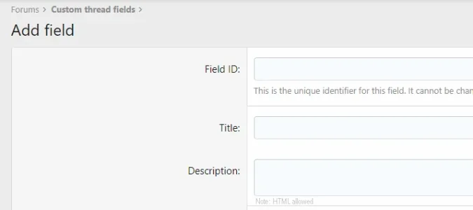

It probably would've taken me much longer to troubleshoot and this might just be an outlier case, but wouldn't a description below the "description" textbox of something like "Note: HTML is allowed" be better for a future scenario?
Seems like something so small that was overlooked, but, the troubleshooting incurred could save someone a couple of minutes (if they put in a bold tag) to hours (if they end the description in a title tag, perhaps).
Example:
