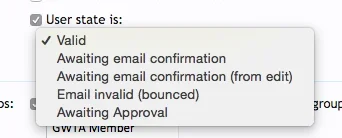

You run a promotion that promotes use the user based upon their user state
They don't receive that user state until they have validated their email... once they do that, then they have access to the node since they are promoted to that user group.
