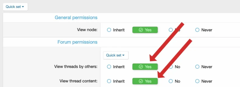

But in node permissions, do they have permissions to view (as well as the node) the threads and content as well as just the node itself?
Yes, they are able to see and post in the private forum. They just don't see new posts from the forum in the New Posts page.

Let me try to expand. I followed the Xenforo manual to set up a private node for when users upgrade. It is set to inherit from the registered user permission set.
All upgraded users can:
  • See the forum;
  • See threads in the forum; and
  • Reply to threads in the forum.
What is happening is that when they click on New Posts, it doesn't contain unread posts from this private forum. It's as if the system is excluding the private forum all together for this purpose.
