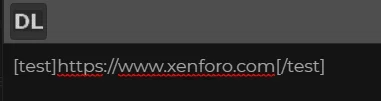

I made a custom BBCode that takes an URL, verify the link, do some stuff, and display the URL with custom formatting
Something like that:
class myaddon_bbcode_downloadLink
    public static function whatever(array $tag, array $rendererStates, XenForo_BbCode_Formatter_Base $formatter)
        $content = $tag['children'];
           // do some stuff
        return $content;
When I post an URL with my custom BBcode, it looks fine at first:
But after posting, the URL is parsed into an embedded link with the page title
How can I prevent parsing url and stripping all bbcode inside my function? I want to keep the raw url as string
Thanks
Enable Disable auto-linking in the Advanced options of your custom BB Code.
Thank you! Not sure how I missed this option, but it did the job!
