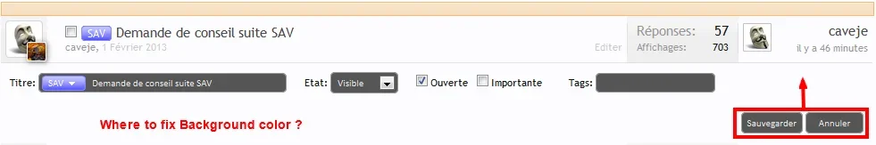

Greeting All,
Anyone know where to fix background color and CSS block in this screen ?
Found those line in inline_mod.css
.inlineCtrlGroup
    background: rgb(150,150,150) url('@imagePath/xenforo/gradients/thread-modctrls-30px-dark.png') repeat-x top;
    color: white;
    font-size: 11px;
tried to change background-color:black for ex, nothing happens
Thank you
Nicolas

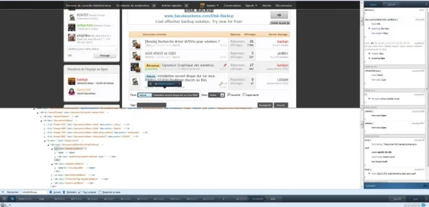

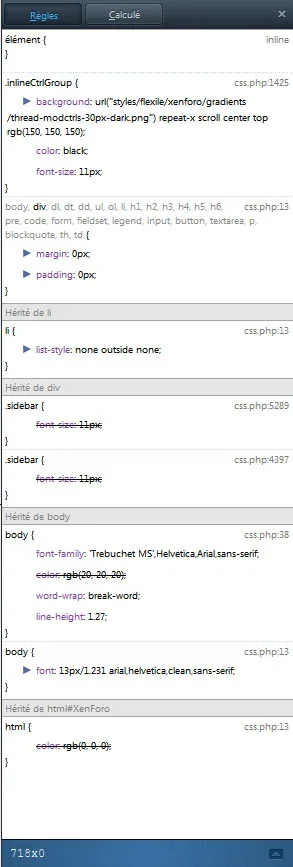

I am running FF, and used the Examine dev tool to check the class :
.inlineCtrlGroup {
    color: black;
    font-size: 11px;
    background: url("styles/flexile/xenforo/gradients/thread-modctrls-30px-dark.png") repeat-x scroll center top rgb(150, 150, 150);

Right click somewhere in inline mod block, select "inspect element". In DOM tree move to div.inlineCtrlGroup, on right you'll see list of rules that are applied to that element.
