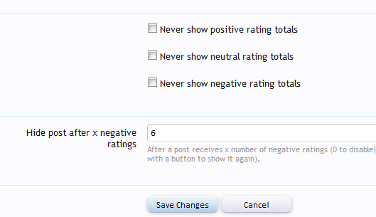

Thanks, but that option is "Hide post after x negative ratings" which would disable/enable if an actual post would be shown or not as a result.
I'm referring to the actual displaying of negative points (and the slash) and how to remove that from the membercard and display near top of sidebar as in the pictures I posted.

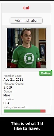

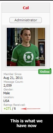

Is it possible to update the information in Style Properties: Message Elements to something nicer? Maybe in the CSS?
I only use the positive and negative versions. Something similar to this I suppose. I'm hoping it can be done without hiring someone, so I'd appreciate anyone with better coding knowledge than me could advise lol.

Cal, is that calculated as an "ending" to know how far the progress of the ratings have gone? Or, is that the ratio of positives to negatives?
I'm quite sure it's the ratio of positives to negatives. I wouldn't imagine it would be logical to have a progression indicator for ratings unless I'm missing the point of that screenshot.

This is useless if a member only has one positive or negative rating. It'll then just be full green or red.
That's what I would assume, but just checking with him. You know what they say about assuming ;)
Plus, if the decision is that he wants to institute this as an option, I want to be sure that DI is clear on the suggestion :D
How would that be any different than having a great poster with 30+ and still 0 negatives?
Personally, I think its kinda cool. I'd probably add the +/- numbers really small underneath the bar, to add to it.
So oldschool :P Why not use javascript to make 2 view options that can be switched with a simple click? Or make it a typical xenforo hover effect.

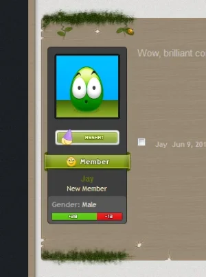

You could probably have the rating count inside the graph container, it'll save breaking onto another line but I guess this type of thing will be down to user preference.
rating.webp​
I actually like that, and it never came to thought. Nice.
I think I'm warming up to the whole graph Ratio >> PR thing and think it's actually a good idea worth exploring, expanding on. I'm trying to figure out designs for such a feature on the chance DI implements this and feels it might be a good addition to the post ratings which quite frankly now, I think it will be.
For some, they'd have the Positive/Neutral/Negative ratings. So, there would be three colors to choose from on the graph :)
But yes, I like the idea (y)
I'm glad everyone likes the idea lol. I figured it would look better cosmetically, it would interest users more - they'd want to keep that green bar up over the red, etc. I just thought it would be great improvement as I (and so does my community) find the numbers to be are rather bland and I don't think a lot of people take notice to them.
It's a ratio based on the number of + and - ratings they get. If we have neutral votes enabled I wouldn't even put them in this, leave them in the alerts where the person can say hey I got a rating, but does not effect the total score.
Shelley's image is perfect!
