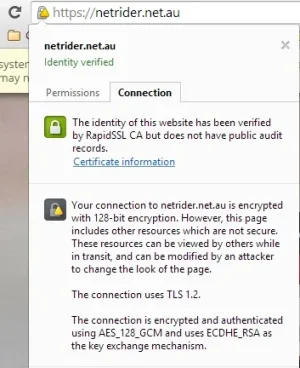

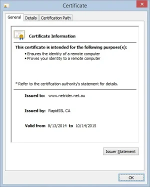

Visit https://netrider.net.au and take a look at the certificate, which is base single domain cert issued to www.netrider.net.au Works fine, with no error or issue from browser.

Not really, you have to look closer. His certificate is fine, which is what you're arguing about. His site happens to be serving both secure and insecure content, but the actual certificate is verified.

In any event, I think the above screenshots are pretty conclusive that you do not need a wildcard cert to support the www subdomain. If the certificate were a wildcard cert it would have been issued against *.netrider.net.au.
Maybe, but his configuration doesn't really have anything to do with how you configure yours.

Is clearly not universally true, since there is an obvious and clearly demonstrated example of using a non-wildcard cert, issued to www.domain.com but supporting domain.com, by a respectable and widely used certificate authority.
His choice to serve insecure ads or other insecure content through his secure website has nothing whatsoever to do with that point.
