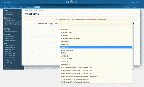

So from that as you say you're using phpBB 3.1.6 you're good. Here is an attached pic of XF1.5 importer, you can clearly see its listed:
