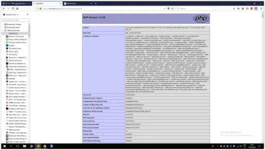

I've upgraded my PHP to 5.4 and 5.6 and re-uploaded the v2 files but still get the php error? am I missing something? I hope this is in the right place? please move it accordingly if not thanks...
it won't work but maybe its a firefox thing? My VPS does give me the option to u/g plesk from v12 to v17 but its a trial and will probably have to pay monthly for it in future but it will give me php v7.2...

What exactly is the error you’re getting and when?
If it’s a warning about 5.6 then you can ignore that and proceed. If it’s a plain white screen with an error about needing PHP 5.4 then your server hasn’t been upgraded as you expect and you’re still running a version below PHP 5.4.
