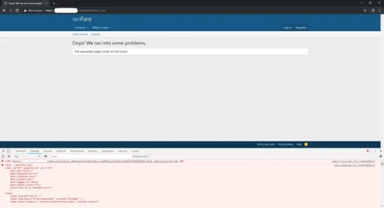

As released of PHP 7.3.0, I install a fress XenForo 2.0.11 to test it the brand new php. No error occured during the installation, but after the installation, can't login to admincp. Forum index also occured error: Oops! We ran into some problems. Please try again later. More error details may be in the browser console.
