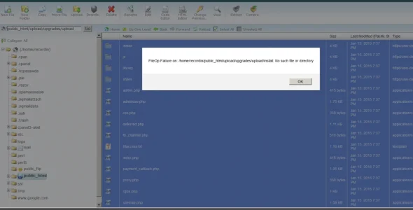

I've been having trouble where I cannot overwrite , upgrade now.
I'm using cpanel. I used to be able to upload a zip, unpack it and drag the entire works onto my public_html folder and it would overwrite everything in a few secs. Run the update url and all is golden.
But the ability to do this stopped.
I can no longer overwrite, specifically public_html directories and their sub directories. The individual files seem to be able to overwrite, but if the upgrade has folder ( as usual), it will not overwrite. I get a message "No such file or directory" see attachment regarding the message.
I'm thinking someone goofed up my user permissions, mixed up root and my account. Is there an easy way to fix this?
Check with your FTP client. Can you upload the files that way? (Particularly into the listed directory.) Otherwise, if it's an ownership issue, they can "chown" the files back to your user; the only caveat is that you may need to ensure that the data and internal_data directories are all 0777'd (recursively), though that does depend on server config.
The path listed there is also a little weird. I see "upload" twice in it (and normally you shouldn't see it at all). I'm not sure if that's relevant.

I created an additional folder to upload my updates, then unpack there. Could this be my problem? Is there a specific folder I should be uploading the zip?
