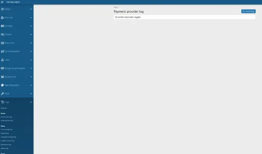

Also check your Xenforo ACP admin.php?logs/payment-provider/ for any hints.
Payment Log in Xenforo wont show anything.

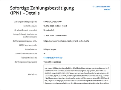

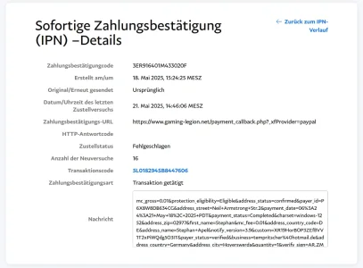

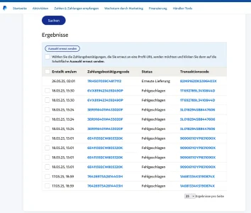

The ipn history shows a lot of failed entries.

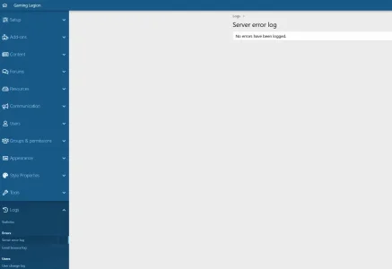

Try looking at your server error log during IPN post times. Maybe the payment_callback.php file has a permission problem.
already tried.
also tried set permission to 777. issue still remains.
error log is also empty

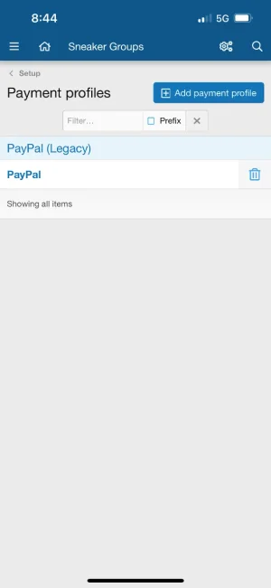

Also check your payment profile. It should look like this. In this section you should have your registered PayPal address.View attachment 323214
im back on XF 2.2.x cause of some mods i want to use that are not supported in 2.3.x.
I have Paypal legacy only. the never version of the paypal payment system is not listed on my side.
The profile is set up correctly and the PayPal email is linked.
