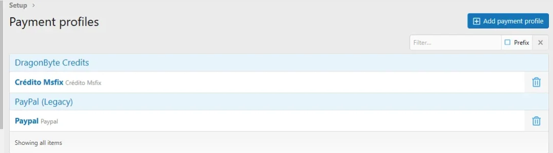

Previously, payment via PayPal was ok in XF2.2...
Then I updated to 2.3.4 and it stopped working...
I have the same problem, a member makes a purchase via PayPal, but nothing happens for a member/VIP member.
I have to do it manually.
I'm very ignorant about this.
If anyone has a solution, please let me know.
If you changed your gateway from Legacy to the new one, this would likely be related, but if you didn't change anything, it is likely a different issue.
Got it...
After the 2.3.4 update I didn't change anything.
I'm a layman.
like PayPal, it's easy to set up, just enter your email (account).
I'll wait for the next VIP member (Paypal).
I'll post the result here soon.
