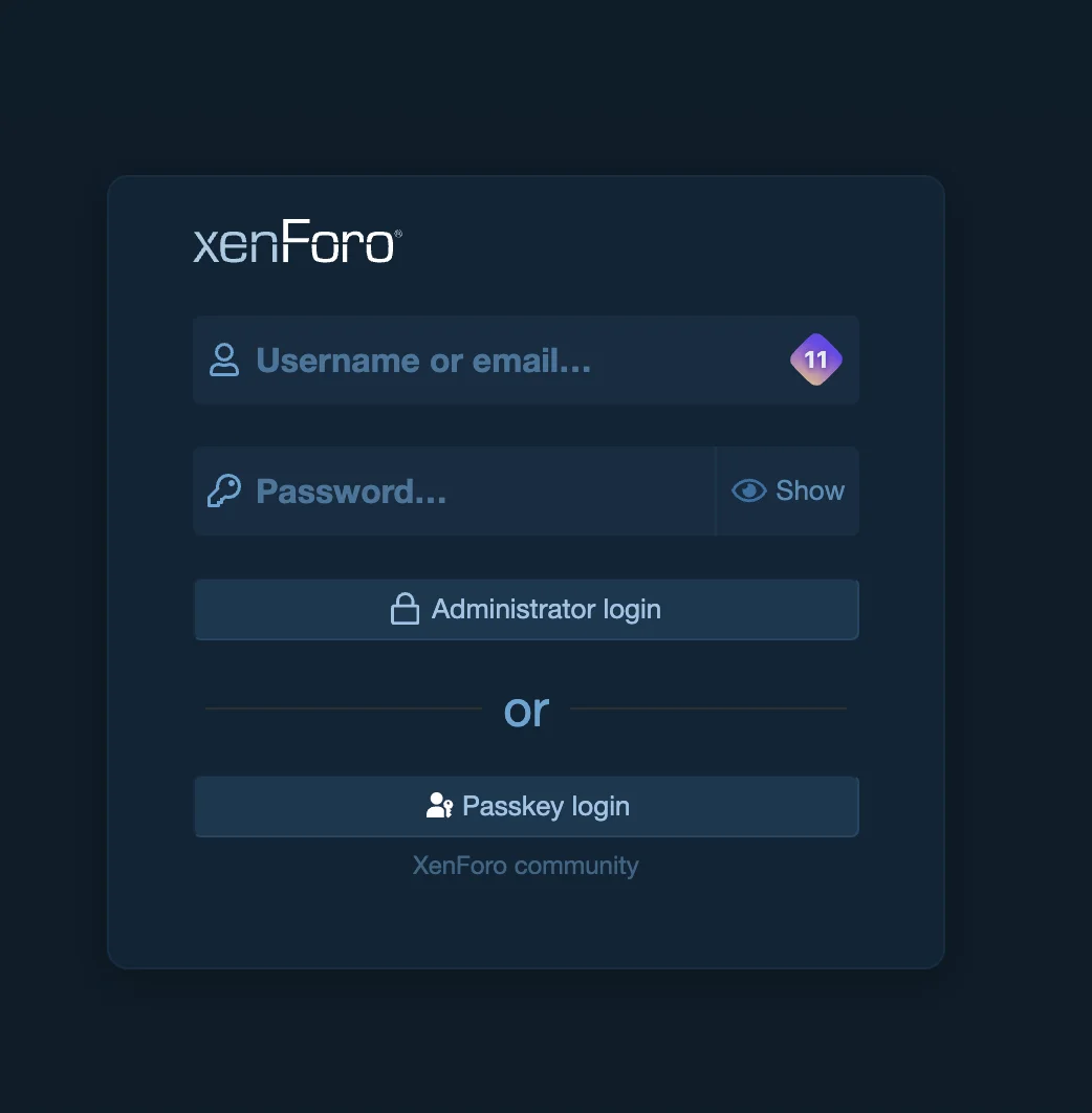

We supporrt logging in to the admin control panel with passkeys starting with Beta 4:
