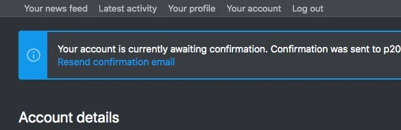

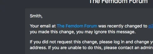

3) I did a email change with the user account and this is where its weird.
The user was notified that the account was waiting for confirmation. The old email account was sent a notice but the new email was not sent a new confirmation request. Nor was the admin notified of a required confirmation. The latter may not be required but surely the confirmation should be.
At this point I have to believe there is a problem with the routine that sends out email when a email change is made.
