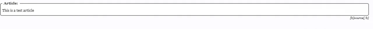

  2. Visual
Results with the above modification
  1. Formatter tree element
    array(1) {
      [0] => array(4) {
        ["tag"] => string(7) "article"
        ["option"] => string(13) "[b]source[/b]"
        ["original"] => array(2) {
          [0] => string(23) "[article=[b]source[/b]]"
          [1] => string(10) "[/article]"
        ["children"] => array(1) {
          [0] => string(22) "This is a test article"
  2. Visual
