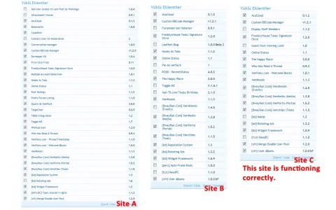

yavuz
#10
I made a screenshot of the addons of all thre websites and combined it in one picture. Since Site C is working with all its addons installed, would it be wise to delete the other addons from the other two sites to test?

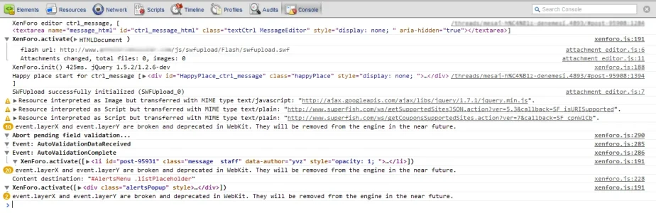

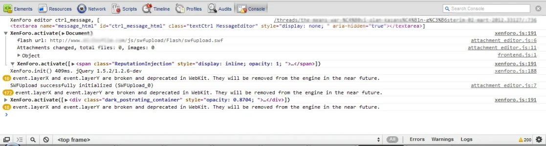

yavuz
#11
I looked both sites in the web console (chrome), removed the errors that was caused by addons. There seem to be errors related to xenforo. As you can seen in the screenshots:
Brogan
XenForo moderator
Staff member
#12
You can disregard those, they are not the cause of your problems.
Essentially you have too many add-ons installed and it is likely that one or more of them are conflicting.
