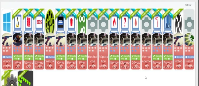

Hello,
I am facing this display after setup :
How to fix this ? Thanks
I category page, the layout does not display.
Using theme : UIX2
Hello,
Using theme : UIX2

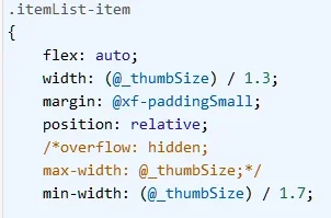

There is templated named dadparvar_xfrmresourceslayouts_resource_list_twosidedbusinesscard.less. Inside that, there is width: (@_thumbSize) / 1.6; set for .itemList-item. If you change that 1.6 to lower, the cards will be bigger. i.e set it to 1.3 now, and you'll have 3 resources per row.
Thank you.
I set it to 1.3
I set it to 0.5
now it is ok, but i have 6 ressources inline
how to set space between blocks ? (right and below) ?

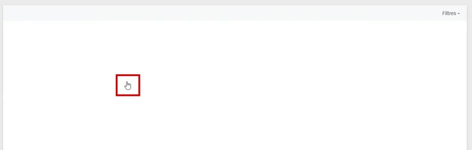

I checked your site, it looks nice now.
Indeed when you clcik a Category on the left, the Blocks do not appear on the page (blank bacground)
Despites, links looks ok when you move mouse over blank space (seems that all css items colors turned white)

PS on live site i reversed to original display. But find a screenshot below :
Thanks
are you using the most recent update? that was in an old version but fixed.
btw, if you update it to the most recent version, and still have the problem (which you shouldn't have), then activate the layout on category and I'll check and will tell you how to fix it in a few seconds.
Still facing the same issue :(
may be due to my theme : UIX2 ?
well, it was normal in their XF1 version to have problem with any add-on.
But TBh, I have no info about their quality in XF2.
Can you activate debug in your site and give me admin access to login and fix it quickly? (send it via pm. after I fixed disable the debug)
