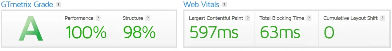

I'm running a custom version of Bolt which is a pretty optimized and fast style.
And as you can see by my numbers, the website is already pretty optimized...
(This is with the add-on disabled)
Hi @duderuud, sorry to hear you didn't have good results, but those are extremely impressive scores without the addon! I don't honestly see what more could be optimized, without knowing further into things like Core Web Vitals directly from Google or Lighthouse/PageSpeed Insights.

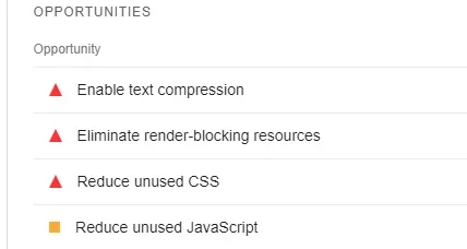

You should definitely fix the enable text compression issue. I doubt the addon can do it. It requires modification of config files of apache/nginx. Relatively easy fix for your host to do it if you are on managed hosting. DOM and CSS related issues are harder I believe.

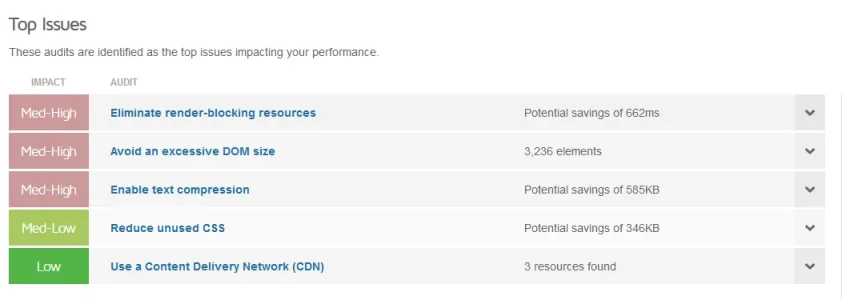

@Nirjonadda It may be able to help with "Eliminate render blocking resources" but I'd need you to PM me the list of resources it mentions. "Reduce unused CSS" is always reported in Xenforo as virtually all speed testing sites consider the core CSS files as unnecessary (loaded in the <head> area) even though they are.
"Avoid excessive DOM size" can absolutely be improved, but not by this addon. It requires your theme and addons to use minimal HTML, and Xenforo already is very complex in front-end HTML structure. In my experience, Xenforo will always be pinged for this.
