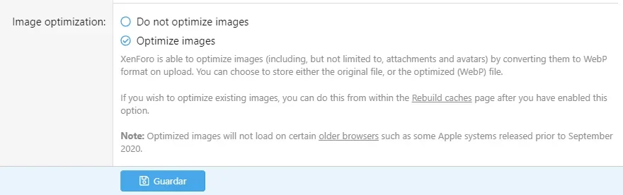

I can't reproduce this. Do you have the image optimization option enabled? If not, the control panel optimization tools and CLI command will not actually perform the optimization.

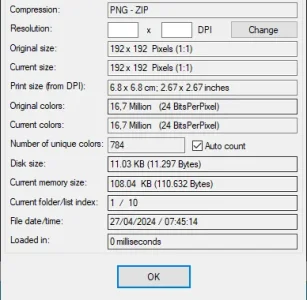

So I updated to beta 3 (without doing a fresh replication of 2.2 database) and ran the commands once again. Files have updated timestamp on ftp but opening them on irfanview confirmed that they remained png/jpgs. It doesn't really matter much as freshly uploaded Avatar and Profile Images do convert to Webp. Plus they don't really take too much space so no major loss of storage space. Would report back when I do a fresh migration on beta 4 which I probably would just install on primary installation 🤪

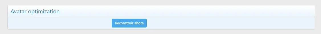

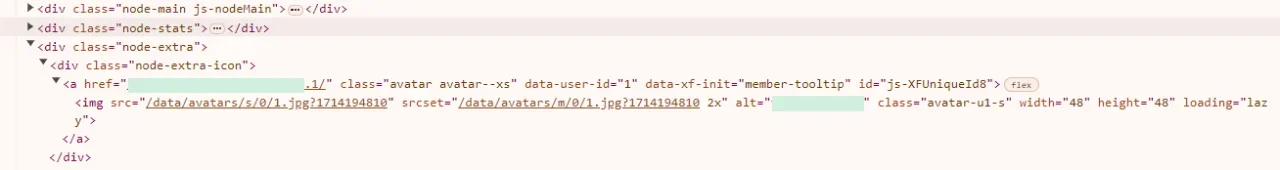

I have used the option to optimize attachments and avatars to convert them to webp, but it does not work with the avatars, they still maintain the jpg extension.
If I download the file, it is still a jpg.
While confusing in practice, the extension has no bearing on the actual media type. You can download the file and open it in a program like IrfanView to be sure.

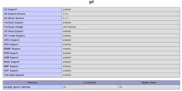

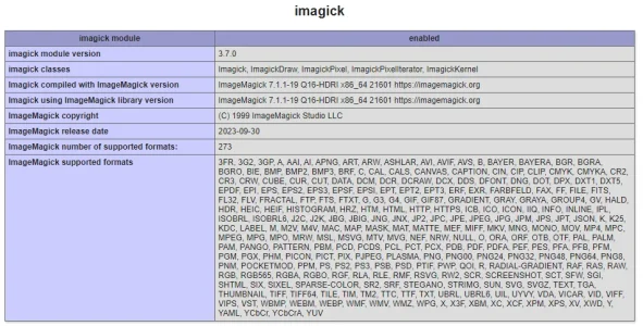

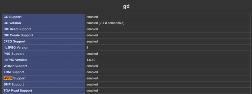

I've merged this into another report of a user experiencing the same issue. Unfortunately we have not been able to reproduce it so far. Are you using the GD or Imagick image driver? If you're using GD, does does WebP support show as enabled at admin.php?tools/phpinfo?
I don't think the file/timestamps would be overwritten if not, but I'm not seeing how this might happen so any further information you have may be useful.

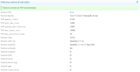

Yes, I'm using Imagick and php 8.3.6

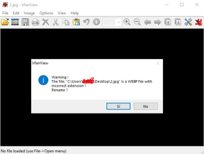

If I download the same jpg image and upload it for another user, it still shows the jpg in the browser but when I open it with IrfanView it already detects the wrong extension :unsure:
So, I switched to GD and ran the commands again. And this time profile images were mostly changed. Got a few errors like:
libpng warning: iCCP: known incorrect sRGB profile
libpng warning: iCCP: cHRM chunk does not match sRGB
GIFs were ignored I guess. Some JPEGs also appeared to be ignored. But it did process most of the user profile pictures! I guess there is no harm staying on GD. Same behavior with profile banners.
