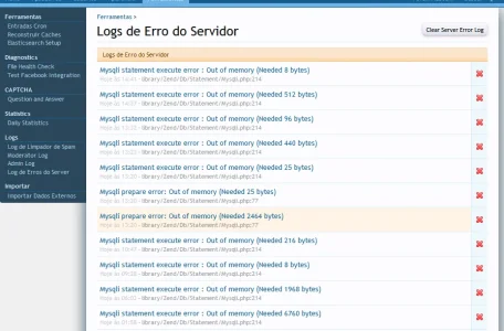

Informação do Erro
Zend_Db_Statement_Mysqli_Exception: Mysqli statement execute error : Out of memory (Needed 512 bytes) - library/Zend/Db/Statement/Mysqli.php:214
Gerado Por: Conta Desconhecida, Hoje às 14:37
Rastreamento de Pilha
#0 /home/plusgsm/public_html/library/Zend/Db/Statement.php(297): Zend_Db_Statement_Mysqli->_execute(Array)
#1 /home/plusgsm/public_html/library/Zend/Db/Adapter/Abstract.php(479): Zend_Db_Statement->execute(Array)
#2 /home/plusgsm/public_html/library/XenForo/Model.php(218): Zend_Db_Adapter_Abstract->query('????SELECT post...', 10414, 2)
#3 /home/plusgsm/public_html/library/XenForo/Model/Post.php(198): XenForo_Model->fetchAllKeyed('????SELECT post...', 'post_id', 10414)
#4 /home/plusgsm/public_html/library/XenForo/ControllerPublic/Thread.php(69): XenForo_Model_Post->getPostsInThread(10414, Array)
#5 /home/plusgsm/public_html/library/XenForo/FrontController.php(310): XenForo_ControllerPublic_Thread->actionIndex()
#6 /home/plusgsm/public_html/library/XenForo/FrontController.php(132): XenForo_FrontController->dispatch(Object(XenForo_RouteMatch))
#7 /home/plusgsm/public_html/index.php(13): XenForo_FrontController->run()
#8 {main}
Solicitar Estado
array(3) {
["url"] => string(69) "http://www.plusgsm.com.br/threads/emulador-vbagx-1-25-o-melhor.10414/"
["_GET"] => array(0) {
["_POST"] => array(0) {
EasyTarget
#11
My webserver is Dedicated Server by SoftLayer
In any case, removed the Maridb and Mysql installed, let's see how it will behave
Three things which version of mysql are you running?
And looking at your my.cnf file I don't see any of the InnoDB specific settings, are they set up?
Are the Xenforo tables InnoDB or did you create them as MyISAM ?
