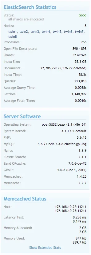

2015 - openSUSE Leap
So... my servers are all running openSUSE Leap 42.1 now, and like I said, it's great. Definitely the best server operating system for what I need.
