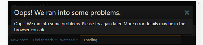

vanucci
Hi guys, i know this isnt a bug with the software and its an issue server side.
I'm getting this issue on a fresh install

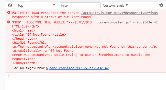

Now When i check console I get these errors
Very unsure of what this may be ?
I have CentOS7 WHM PHP 7.1

I'm getting similar issue:
Failed to load resource: the server responded with a status of 403 (Forbidden)
core-compiled.js:42 PHP: <!DOCTYPE HTML PUBLIC "-//IETF//DTD HTML 2.0//EN">
<html><head>
<title>403 Forbidden</title>
</head><body>
<h1>Forbidden</h1>
<p>You don't have permission to access /mxcro/forum/admin.php
on this server.</p>
</body></html>
Ok, my .htaccess file didnt have mod rewrite on it. Solved the issue.
added a .htaccess file to the root directory. Mine was pretty much empty.
