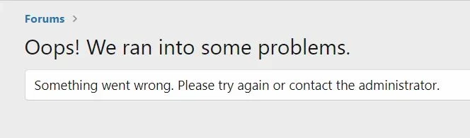

XF 2.1 Oops - Cannot open a thread - link does not work but is in DB
Have any redirects in place? Something in .htacess? Try on a unmodified default style with all addons disabled?
What changes to the site happened before this issue arose?
There are no redirects, nothing in .htacess. I have removed .htacess with no help. I have tried the default style (using it currently) with all addons disabled.
There were no changes before this happened except for the import from VB 3.8.
The link has never worked since just after the import VB forum import.
I suspect you're running into a situation where we have a thread record but no posts. The comment in the code sums up our thoughts:
// should never really happen
return $this->error(\XF::phrase('something_went_wrong_please_try_again'));
Unless something went terribly wrong with the import or the DB was manually manipulated, this would indicate that there were no posts in these threads in the source DB. You would need to confirm that there. Note that any change here is likely to require a re-import and I don't know if you consider that viable (as it would likely require reinstalling XF).
