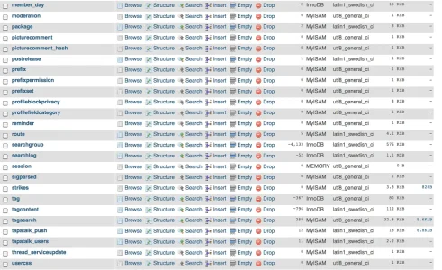

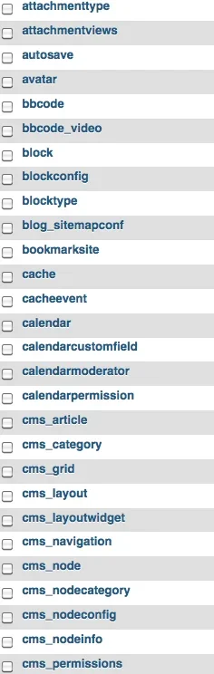

It's impossible to say as add-ons may not be prefixed with xf_.
Did you install XenForo using the same database as your existing vBulletin installation?
You will have to manually check each one and ensure it is not used by your XenForo installation.
The date of the last entry in the table may help.

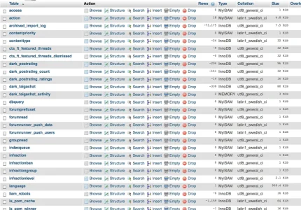

Thanks, sir. But, I do not see any dates.
