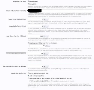

I'm still experiencing this issue on both the forums I admin. On the reef2reef.com forum however, it literally never happens. Using the same browser, same PC. In fact it happens on my iPhone as well. This makes me wonder if it has to do with image proxy settings or something.
I have contact R2R admins to see what their settings are but if anyone can tell me if the following settings might be causing this issue your insight would be appreciated.
