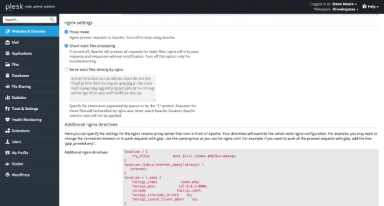

So here is my problem, I run nginx, I used the information here, https://xenforo.com/help/friendly-urls/, but still does not work. I have added the information to the additional directives box for nginx on my Plesk Onyx install. I had it working at one point but javascript and other parts would not load so I scrapped it and started over. Now I'm here asking for guidance.

I have also attached a screenshot of my nginx settings via plesk.
