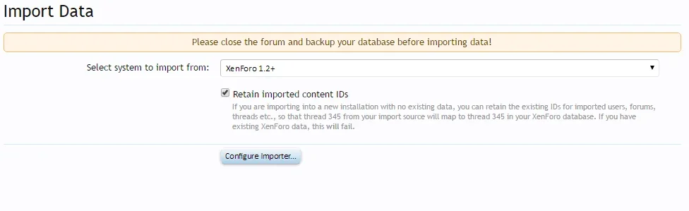

hi all, i am completely and utterly new to all this and am a starter and beginner.
OLD INSTALL was on 1.5.11 -> NEW INSTALL is on 1.5.12
1) i had a XenForo Installation, where i created FORUMS and CATEGORIES, but nothing else. (nothing else, was just created NODES [infrastructure)
2) then due to hosting being very slow, i moved from 1&1 Germany to i3D.net
3) on i3D.net i installed completely from scratch, fresh installation and new, and it works
4) now i want to import the FORUMS and CATEGORIES that i created on the 1&1 installation into the new/ fresh installation on i3D.net

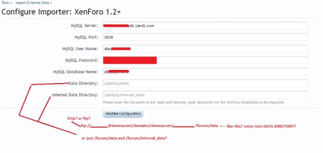

5) i tried with the IMPORTER, but don't get anywhere and don't know what else to do.
*** only installed RESOURCE MANAGER (was identical on old installation)
*** only installed DISABLE RSS (ANDY) (was identical on old installation)
any help is greatly appreciated and sorry if all my questions are stupid or easy for some, i just don't get it.
what am i doing wrong? or how to do it correctly?
thanks again everyone.
attached screenshots.

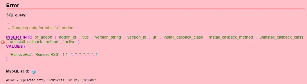

Since you're dealing with the database level, you can't have a new installation and the importer is not directly relevant.
You need to empty the new database (as in remove all tables or just delete and recreate it) and then try to import your database backup into it. Your errors are because it's not empty. Ideally, you should move your old files to the new host as well. Once you do all that, you'll need to update library/config.php to the MySQL details for your new host. If this is all done, your existing install should be migrated and you can go from there.
(See #6 in this post: https://xenforo.com/community/threads/frequently-asked-questions.5183/#post-180455)
I understand you want to copy your node structure between two different XenForo installations. Here are some options:
1) Don't use a second installation. Instead just copy the existing installation by doing a backup / restore cross servers.
https://xenforo.com/community/resources/how-to-backup-and-restore-your-forum-linux-windows.359/
2) Do an import from XenForo to XenForo.
https://xenforo.com/help/importing/
https://xenforo.com/community/threads/import-guide.10053/
This still requires you to backup + restore the database on the new server so you can import from it on the new server.
3) Manually restore individual node related tables from the original database to the new database. This requires SQL ability and may be problematic with respect to relations in your database. Not recommended.
4) Manually recreate your node structure using the Admin CP and the old forum for reference.
