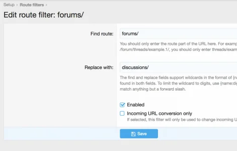

Then i've added a route filter that points discussions to forums
Now when i go to the link on the front end, i cannot see it selected. ( I am using the default XF2 theme)

The selected navigation tab of most pages (with the exception of individual nodes) is hard-coded at the route layer. I don't believe the behavior you want is supported out of the box.
Hmm, you could actually try making the navigation ID 'forums' (and keep everything else the same). I think that's all the code is looking for.
If this is actually a page, then you can set the selected navigation tab in the page's configuration.
However, it is correct that in most cases, the section is selected via code. It can be changed via template edits though.
I'm a bit confused about what is going on here exactly though, as if you're just changing forums/ to discussions/, you would be better customizing the existing "forums" navigation tab and/or children, rather than creating an all new one.
