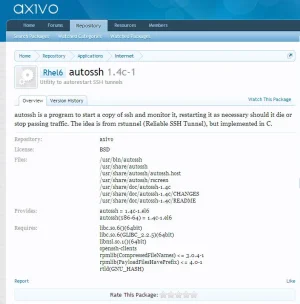

I've been breaking my head for last 3 hours looking everywhere to see what could cause this issue:
The link with the padding-top issue is:
https://www.axivo.com/articles/welcome-to-axivo.1/
The one that works properly is:
https://www.axivo.com/packages/elasticsearch.41/
The CSS is identical into templates. For some reason, I see loading the .messageSimple .comment, .messageSimple .secondaryContent section. I've been working a lot on this site and it really bothers me to see a little inexplicable thing like that happening. Thank you for helping out.

Seems to give the correct margin-top: 10px.
In the CSS, try using .packageUpdate .messageSimple .comment, .packageUpdate .messageSimple .secondaryContent (without registering an account and logging in - that's a guess.) and tweaking the padding in there.

Without registering I can't really see any problem other than a slight difference in the padding on the images you've posted.
@Azhria Lilu, that is what I'm trying to solve, I need to understand why the wrong class is loaded first? I guess there is an ID stored into database, in what table the style is stored? I did not have time to delve too much into styling. Something is forcing to load the class into wrong order, no idea what.
Edit: In my screenshot, you can see clearly that the 10px padding is added below the Likes, not above where it should.
As i said, if you put what I wrote above in EXTRA.css, and tweak the padding - that should fix it. I can register an account and double check if you want.
@Azhria Lilu, my point is: I should not do anything, the CSS is there and proper. But for some reason is not loading properly, adding anything to EXTRA.css will not solve the original question which is: Why the existing class with right code is not loading properly?
