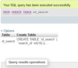

I need you to expand that so I can see the full values of the response.
This isn't an error that should be possible. The automatically increasing counter is handled within MySQL itself and we have minimal direct control over it. We don't actually request a particular value here, so if MySQL isn't giving a usable value, it could indicate some amount of DB corruption, though I'm not positive.
This?
Your SQL query has been executed successfully.
SHOW CREATE TABLE xf_search
xf_search CREATE TABLE `xf_search` (

Well something broke in MySQL then, as the auto_increment value is wrong, given the last value in the table. This isn't something we have any control over, so I really don't know what would've caused it.
You can try running this query:
ALTER TABLE xf_search AUTO_INCREMENT=28595108;
I do note that the table is also MyISAM, as I assume you don't (or didn't) have InnoDB available. This isn't really ideal either and could possibly be somewhat related.
Thank you! That fixed it, just saw the first real search results in several days. :)
