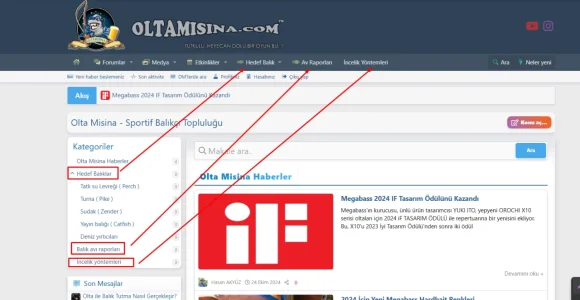

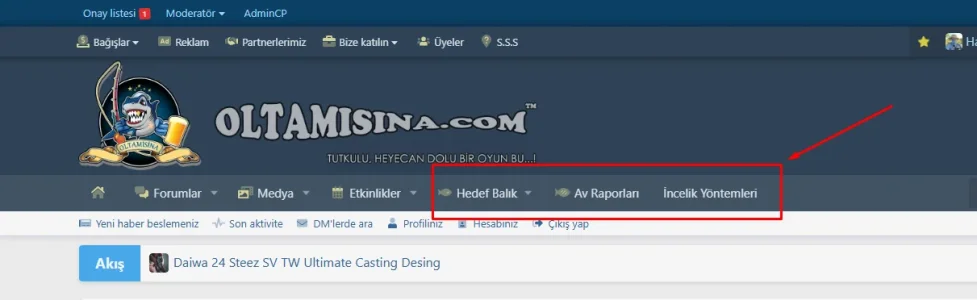

I added the 3 navigation menus seen in the first picture later.

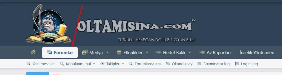

My problem here is that normally when I click on the navigation menu, it should be selected as in the image below, but it is not selected when I click on the navigation menus that I added in the first image.

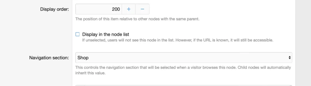

If it is a forum node you can specify the tab that should be selected under navigation selection.

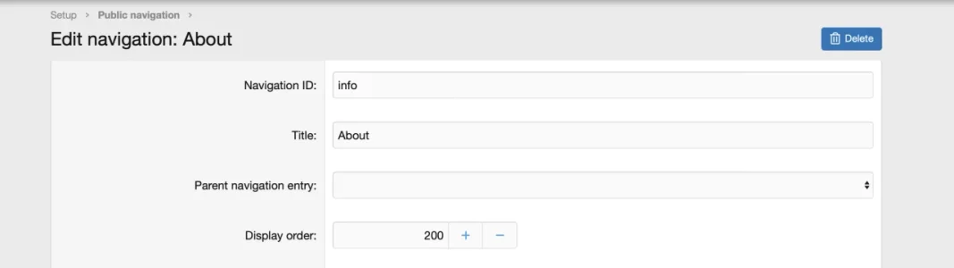

The navigation id is shown in the navigation setup:
So in this case

If it is a page node then you select it in the node setup itself as in my first screenshot. If for example it is a help page then put the code at the top.

If it is to a category, then the category node settings have a navigation selection choice as in my first screenshot.
