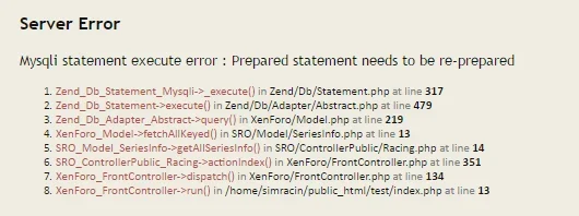

Hello. I have this MySQL problem when I try to run a sql statement. I've looked through the forums and found several posts about this. The posts suggest I contact the host and have then restart MySQL. Their response was this:

Here is the function with the Select that is failing. It is selecting from a View.
public function getAllSeriesInfo()
return $this->fetchAllKeyed('SELECT * FROM SRO_series_view ORDER BY SeriesName', 'Id');
Attached is an image of the XF error message.
I certainly can't see anything wrong with that SQL so it is likely to be related to the threads you have seen elsewhere.
