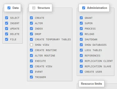

You need to ensure the user associated with the database has full permissions.
If it was working recently and has changed without you doing anything, then something has changed on the server.

I misread it as xf_user but yes, that is the table which contains the records of the mysql users and their privileges.
You would have to inspect the script to determine why it's trying to access that table - it shouldn't be involved in a standard dump of XF.
