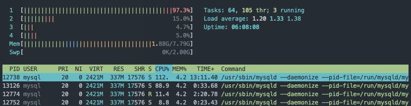

XF 2.2 MySQL using 100% CPU with this query, can't make it stop
Phid
Dear Sir/Madam,
We recently upgraded to XF 2.2 and today we noticed the forum was running very slow and checking the server we noticed a high CPU usage coming from MySQL, checking the db process list we only found 3 processes running the same query which is:
SQL:

Btw, I managed to grab this message from the AdminCP:
There are scheduled jobs outstanding which have not run. Jobs may not be getting triggered when expected.​

Which version of mysql is running?
Speaking with the dev's, this query was tweaked to make it more efficient in 2.2 (it's related to user name changes, merges, etc.).
