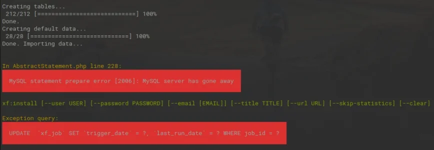

CLI Install error

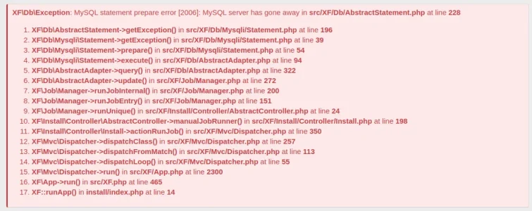

Web Install error
There won't be anything to us to change here. It will be a server configuration issue.
I'd most likely check wait_timeout first but if you search for that error on this forum you may find other recommendations.
I'll try to increase wait_timeout now.
This is a new server in DO 2cpu/2gb ram for testing.
Mysql wait_timeout and PHP max execution increase to 180, but still the same error :/
What was the wait_timeout value before you changed it?
The default is typically 28800 so 180 would be far from sufficient.
Also no reason to increase PHP max_execution timeout for this as that isn't a factor in this issue.
