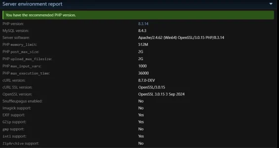

My server environment:
Image taken from a stock (full) install of XF 2.3 within the same environment, which installed successfully.

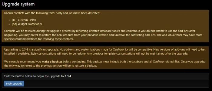

The initial part of the installation that progresses from XF 2.0.0 and onward seems to have run successfully, but when I get to (final?) step to upgrade to 2.3.4:
Upon clicking the Begin upgrade button, after a while the MySQL server crashes with the browser reporting the following:
An exception occurred: [XF\Db\Exception] MySQL statement prepare error [2006]: MySQL server has gone away in src\XF\Db\AbstractStatement.php on line 230
