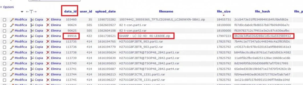

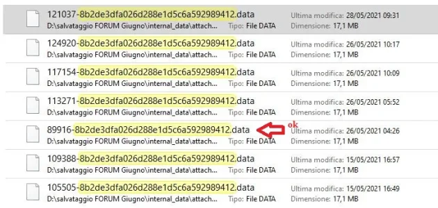

A few months ago I needed to update the Xenforo 2.0 version to version 2.2. I saved the whole forum including the internal_data folder. Everything went well but I discovered that the internal_data folder has become very heavy about 150GB I checked XF_ATTACHMENT_DATA in my SQL database but everything is ok. But I still did another test and I realized that a file I have 6 copies. The file_hash is repeated several times in some internal_data folders. For example

Surely it happened as you say,. How can I clean up the internal folder_date from the replicated files? Make it manually is really unthinkable. The MySQL file is restored perfectly but the files replicated inside the internal_data folder are present. There is an addon that crosses the data from mysql xf_attachment_data and the internal_data folder gives me the opportunity to clean it in a short time?
