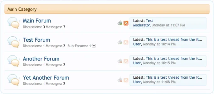

I hope to complete an update soon which will allow users to add / remove forums from their Multiview listing, from the forum list itself.
There will be a new icon next to the RSS feed icon, as below.
This can be disabled from the Options.

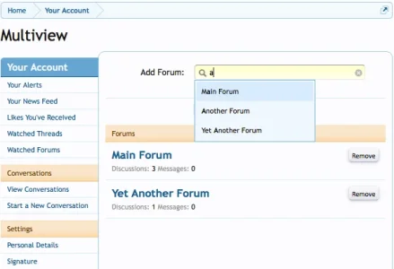

In a future update I hope to allow users to manage their included forums from the Account page (similar to the '
People You Follow' page).

Searching for forums would certainly work and look nice. I just wonder if having them already listed might be more useful for forums with a lot of subforums. Something like this is what I had in mind.
I was hoping to eliminate the link to toggle from the forum list. I have a few other addons that have tapped into that same location so I'm not sure I would want to add anything else there. I don't see members toggling forums all that often for this addon. Seems more like something that they'd configure once and maybe tweak a few other times then basically leave it that way forever.
Yeh, and actually, at the moment if you add a parent forum, it doesn't add any child forums (if there are any) - they would have to be added separately. I'm going to add an option to optionally 'Include sub-forums" when adding a parent forum.
What you say about a user configuring it once, and then leaving it, is true, and I hadn't thought of that. It's not something that would change regularly, so perhaps the toggle option on the forum list is less useful (and less needed).
I'll try and come up with something based on what you've said, and I'll post back soon.
Thanks for listening!

The main change is the forum autocomplete feature within the Account page, but there have been many changes to other parts of the add-on, and these things are working hand-in-hand.
