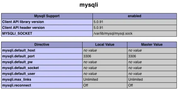

If you upload this phpinfo.php file (attached below) then you can confirm that mysqli is not installed. You should see a mysqli section in your phpinfo, like this:
If it's not there then mysqli is not installed.
The error indicates otherwise. Could be what Clickfinity said. But basically contact your host again.
