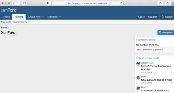

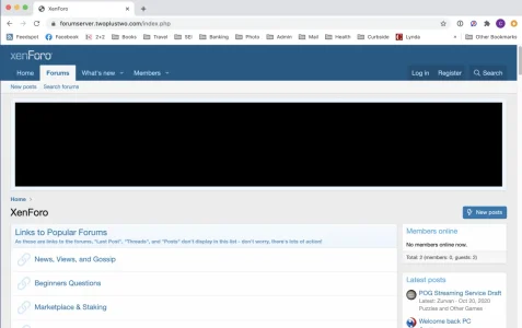

I did an import of a VB3.8 forum on a cloud server and verified that the resultant xenforo 2.1 forum worked at least to the level of being able to read posts. I then dumped the database and restored it to a database of the same name on the new server, and made a copy of xenforo 2.1 and installed in installed it on the new server. The URL is the same on both servers. But when I go to the URL on the new server I do not see any forums or posts.
I'm attaching screenshots from both.
Any thoughts?

I assume you either used identical database credentials or updated the config.php file with the details for the new server.
The second image looks like an issue with templates - try navigating to /install and rebuilding the master data.
If that doesn't work then something has gone wrong with the dump and restore.
