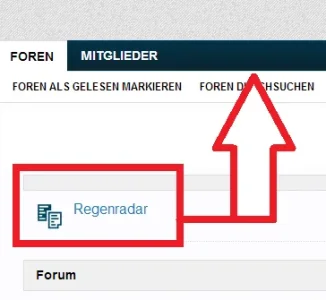

Hello, I want to have a page within my navigation bar. what do I have to do to achieve this?
Thank you very much!

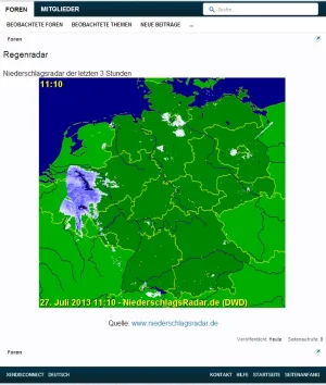

well, but how do I make my tab selected or where do I register my new tab?
        <li class="navTab regen {xen:if $tabs.regen.selected, 'selected', 'PopupClosed'}">
            <a href="pages/niederschlag_regenradar/" class="navLink">Regenradar</a>
            <xen:if is="{$tabs.regen.selected}"><div class="tabLinks"></div></xen:if>
        </li>
where do I register or declare my tabs.regen ?
thanks
localhost8080
it links to "pages/niederschlag_regenradar/
here:
        </li>
