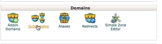

I have done this, but from a subdirectory to root. I'm sure you will need to keep the sub domain and redirect everything to the main domain. However if you have cpanel, you can do this directly under the subdomains
vbulletin redirects should work as before.
