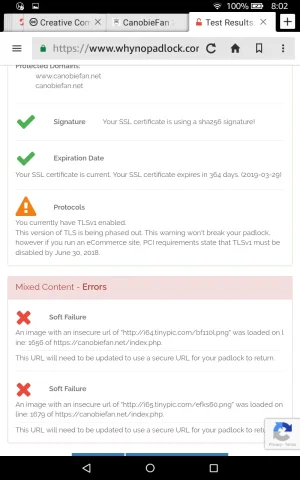

Apologies for the double post -- One interesting thing to note, on my forums, the little lock (URL bar) only shows up when I'm logged in.

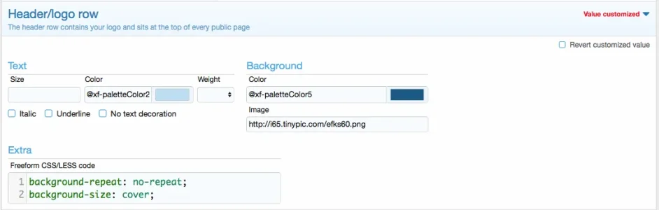

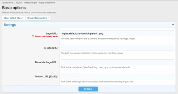

Where would I input info for my header image? That is the one trailing with /efks60.png. I wonder what the other one is (/bf110l.png)? My logo is local.
